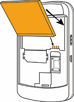

  1. Remove the battery cover (located on the back of the device).
  2. Remove the battery.

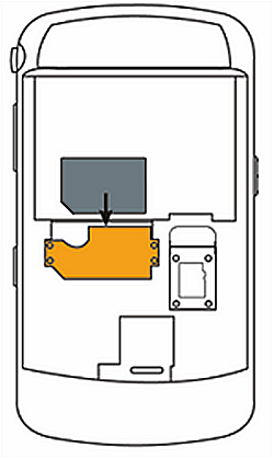

  3. Line up the SIM card with the card slot as shown.
    Ensure that the metal contacts on the SIM card align with the metal contacts on your device.
  4. Insert the SIM card into the card slot.
  5. Seat the SIM card completely into the card slot as shown.
  6. Re-insert the battery.

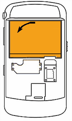

  7. Replace battery cover.

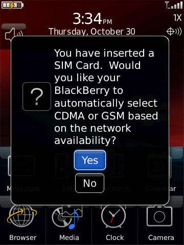

  8. If prompted, select Yes then press in on the touch-click screen.
    This message will also appear if the handheld software is reinstalled.
